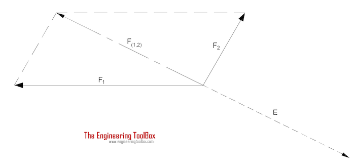

The force required to keep a system of forces in equilibrium is called the equilibriant of the system.
Equilibrant - the force required to keep a system of forces in balance
In the example above the two forces F1 and F2 can be added to F(1,2)
The equilibrant E acting in the opposite direction of F(1,2) keeps the system in balance.
