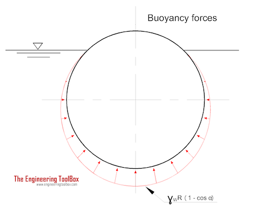

Buoyancy is the resultant force acting on a submerged body.
Buoyancy Forces
Buoyancy is defined as the tendency of a body to float or rise when submerged in a fluid. The resultant force acting on a submerged body by the fluid is called the buoyant force and can be expressed as
F = V γ
= V ρ g (1)
F = buoyant force (N)
V = body volume (m3 )
γ = ρ g = specific weight of fluid (N/m3 )
ρ = density of fluid (kg/m3 )
g = acceleration of gravity (= 9.81 m/s2)
The buoyant force acts upwards.

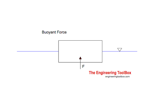

Example - Buoyant Force acting on a Floating Box
Box Buoyancy
A plastic box with length 0.3 m and width 0.4 m is submerged 0.1 m into water.  The water density is 1000 kg/m 3.
The buoyant force acting on the box can be calculated with (1)
F = (0.3 m) (0.4 m) (0.1 m) ( 1000 kg/m3 ) ( 9.81 m/s2)
= 119 N
