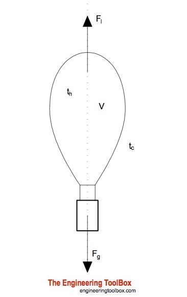

The lifting force from a hot air balloon depends on the density difference between balloon air and surrounding air, and the balloon volume. The lifting force can be calculated as
F l = V (ρ c - ρ h ) a g (1)
F l = lifting force (N, lbf )
V = balloon volume (m3, ft3 )
ρ c = density cold surrounding air (kg/m3, slugs /ft3 )
ρ h = density hot balloon air (kg/m3, slugs /ft3 )
a g = acceleration of gravity (9.81 m/s2, 32.174 ft/s2)

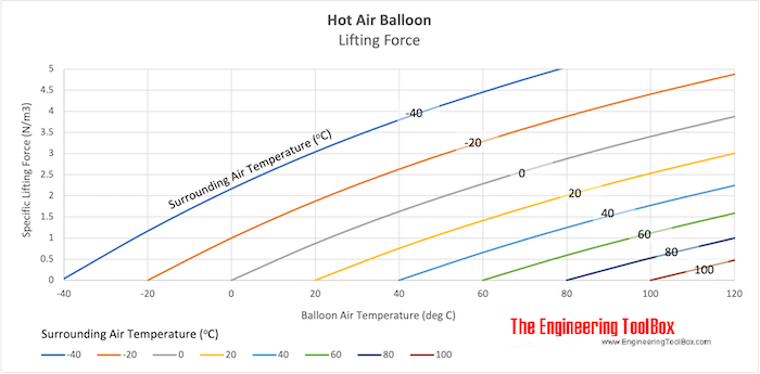

Hot Air Balloon - Specific Lifting Force
Specific lifting force (force per unit air volume) created by an hot air balloon - balloon temperature vs. surrounded air temperature - are indicated in the charts below.
SI - units

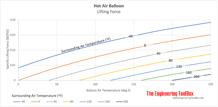

Imperial Units
Hot Air Balloon - Specific Lifting Force - Imparial Units

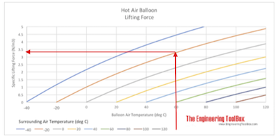

Example - Specific Lifting Force from a Hot Air Balloon
Hot Air Balloon - Lifting Force Example
If the balloon temperature is 60 oC and the surrounded temperature is -20 oC - the chart indicates a specific lifting force
3.3 N/m3
