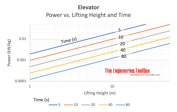

Power required to move the Elevator
The power required to move the elevator can be calculated as
P = W / t
= m a g (h1 - h0 ) / t (6)
P = power (W, ft lbf )
t = time to move the elevator between levels (s)
Example - Force and Power to Lift an Elevator
An elevator with mass 2000 kg including passengers are moved from level 0 m to level 15 m . The force required to move the elevator at constant speed can be calculated as
F c = (2000 kg) (9.81 m/s2)
= 19820 N
The power required to move the elevator between the levels in 20 s can be calculated as
P = (2000 kg) (9.81 m/s2) ((15 m) - (0 m)) / (20 s)
= 14865 W
= 14.9 kW
