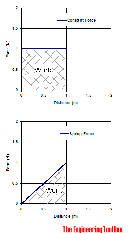

The work done by a constant force is visualized in the chart above. The work is the product force x distance and represented by the area as indicated in the chart.

The work done by a spring force is visualized in the chart above. The force is zero with no extension or compression and the work is the half the product force x distance and represented by the area as indicated. The work done when a spring is compressed or stretched can be expressed as

A spring is extended 1 m. The spring force is variable - from 0 N to 1 N as indicated in the figure above - and the work done can be calculated as
Wspring = 1/2 (1 N/m) (1 m)2
= 0.5 (J, Nm)
The spring constant can be calculated by modifying eq. 4 to
k = 2 (0.5 J)/ (1 m)2
= 1 N/m
