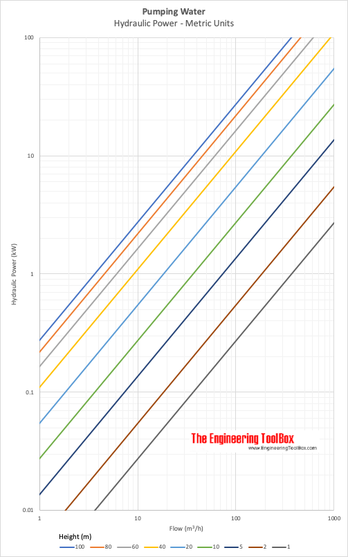

Pumps - shaft power vs. flow and lift diagram - Metric units

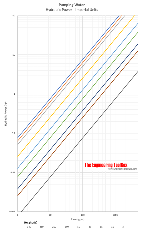

Pumps - shaft power vs. flow and lift diagram - Imperial units
