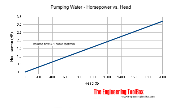

Required horsepower (hp) to pump 1 cubic foot of water per minute (ft3/min) with efficiency 85% - is indicated in the diagram below:
Pumping water - horsepower versus head
  • 1 hp (English horse power) = 745.7 W
  • 1 ft (foot) = 0.3048 m
Example - Required Power to lift 10 ft3/min of Water 600 ft
According the diagram above 1 hp is required to lift 1 ft3/min of water 600 ft. Required power to pump 10 ft3/min can be calculated as
(10 ft3/min) (1 hp) / (1 ft3/min) = 10 hp
