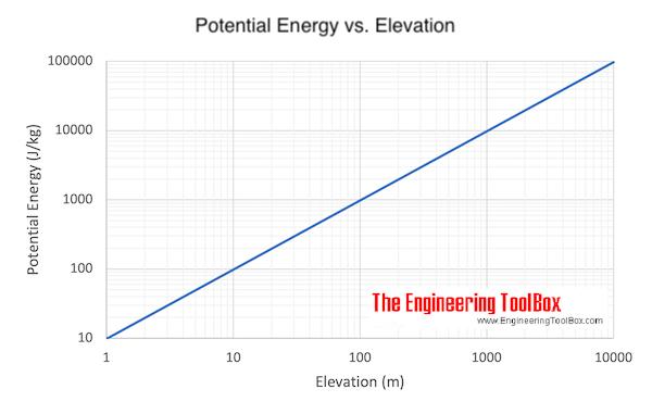

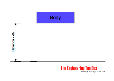

When a body of mass is elevated against the gravitational force - the increase in it's potential energy can be calculated as
Ep = F g Δh
=  m a g Δ h                                (1)
F g = gravitational force ( weight ) acting on the body (N, lbf )
Ep = potential energy (J, ft lb)
m = mass of body (kg, slugs )
a g = acceleration of gravity on earth (9.81 m/s2, 32.17405 ft/s2)
Δ h = change in elevation (m, ft)
Example - Potential Energy of Elevated Body - in SI units
Potential elevation energy
A body of 1000 kg is elevated 10 m . The change in potential energy can be calculated as
Ep = (1000 kg) (9.81 m/s2) (10 m)
= 98100 J
= 98 kJ
= 0.027 kWh
