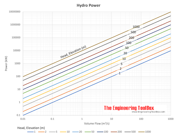

The calculator below can be used to calculate available hydroelectricity power.
The theoretically power available from falling water can be expressed as
Pth = ρ q g h                      (1)
Pth = power theoretically available (W)
ρ = density (kg/m3) (~ 1000 kg/m3 for water)
q = water flow (m3/s)
h = falling height, head (m)
hydropower, volume flow, head and power generation
Download and print Hydro Power vs. Volume Flow and Head chart
Example - Hydro-power
The theoretically power available from a flow of 1 m3/s water with a fall of 100 m can be calculated as
P = (1000 kg/m3) (1 m3/s) (9.81 m/s2) (100 m)
  = 981 000 W
  = 981 kW

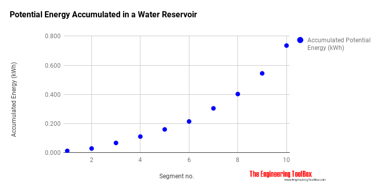

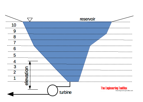

Potential Energy in a Tank or Reservoir
Energy water reservoir
You can estimate the total energy in a tank or a reservoir where the surface area varies with elevation - as typical in a natural reservoir - by integrating the potential energies for horizontal segments as done in the template
Potential energy accumulated in a water reservoir - hydro power
Copy the document to your Google Drive or download it as a spreadsheet to make your own calculations.
