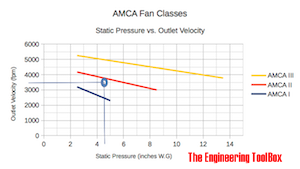

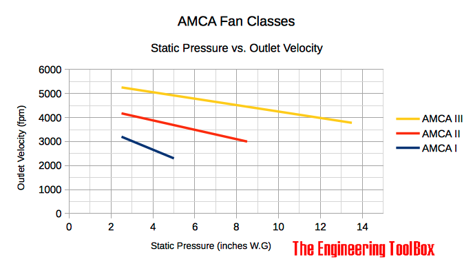

AMCA Fan Classes I II III - Static Pressure vs. Outlet Vleocity
Example - Classification of Fan
AMCA Fan Classes I II III - Static Pressure vs. Outlet Vleocity - Example
A fan working with static pressure 4.5 in W.G. and outlet velocity 3500 ft/min is within AMCA Fan Class II.
