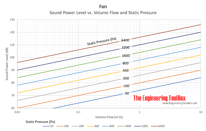

LN = 67 + 10 log(S) + 10 log(p)                              (1a)
LN = 40 + 10 log(Q)+ 20 log(p)
(1b)
LN = 94 + 20 log(S) - 10 log(Q)
(1c)
LN = sound power level from fan (dB)
S = rated motor power  (kW)
p = fan static pressure  (Pa, N/m2)
Q = volume discharged (m3/s)
Fan - sound power noise vs. volume flow and static pressure - chart
Download and print Fan - Generated Sound Power vs. Volume Flow and Static Pressure chart
