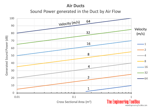

Air flow in ducts generates noise. The noise in the duct is determined by
  • air velocity
  • duct size (cross sectional area)
Generated noise can be calculated with the empirical equation
LN = 10 + 50 log (v) + 10 log (A)                                                       (1)
LN = sound power level in the duct (dB)
v = air velocity (m/s)
A = air duct cross sectional area (m2)

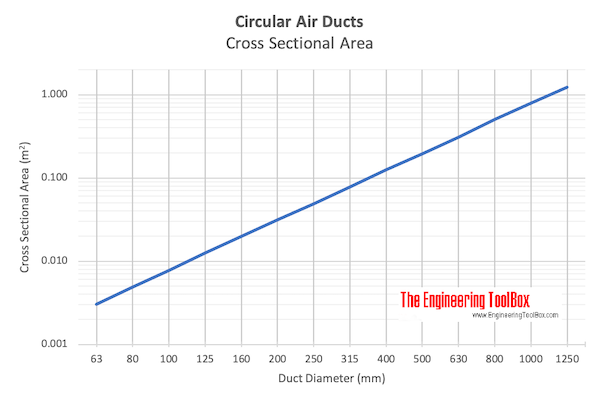

Circular air ducts - cross sectional area
Example - Generated Noise in Duct by Air Flow
The cross section area of a 200 mm duct can be calculated as
A = π ((0.2 m) / 2)2)
   = 0.0314  m2
The noise generated in the duct with an air flow velocity 10 m/s can be calculated as
 LN = 10 + 50 log (10 m/s) + 10 log (0.0314 m2)
    = 45 db
The noise generated in the same 200 mm circular duct as above with air flow velocity 20 m/s can be calculated as
 LN = 10 + 50 log (20 m/s) + 10 log (π ((0.2 m) / 2)2)
    = 60 db
Note! - due to the noise generated by fans - noise generated inside ducts by air flow can in general be neglected.
