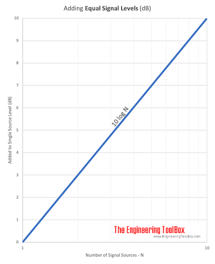

Adding Equal Signal Levels
The total signal level in decibel from equal signal sources can be calculated as
Lt =  10 log (n S / Sref)
    = 10 log (S / Sref) + 10 log (n)
    = Ls + 10 log (n)                                                         (1)
Lt = total signal level (dB)
S = signal (signal unit)
Sref = signal reference (signal unit)
n = number of sources
Ls = signal level from each single source (dB)
The signal units depends on the nature of the signal - W for power, Pa for pressure and so on.
Note! -  adding sound pressure levels.
Example - Total Sound Power from Two Identical Fans
For sound power it is common to use 10-12 W as the reference sound power. Total sound power from two identical fans each generating 1 W in noise power can be calculated as
Lt =  10 log (2 (1 W) / (1 10-12 W))
              = 123 dB
Sound power and sound power level are often used to specify the noise or sound emitted from technical equipment like fans, pumps or other machines. The "sound" measured with microphones or sensors (meters) are sound pressure.
Adding Equal Signals Units Calculator
Adding Equal Signal Levels (decibels) Calculator
Adding equal signal sources can be expressed graphically
Decibel - adding equal sound level sourcesDownload and print Adding Signal Level of Equal Sources chart.
Note! Adding two identical sources (doubling the signal) will increase the total signal level with 3 dB (10 log(2)).
Decibel - Adding two Identical Sources

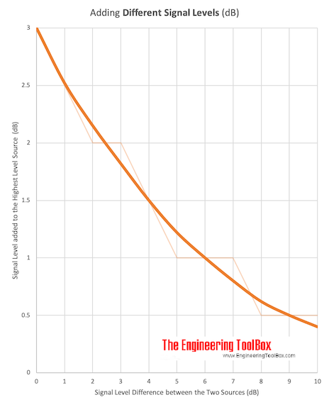

Adding Signals from Sources with different Strengths
The total signal level from sources with different strengths can be calculated as
Lt =  10 log ((S1 + S2 ... + Sn) / Sref)                                               (2)
Example - Total Sound Power from Two different Fans
The total noise power from two fans - one with sound power 1 W and the other with sound power 0.5 W - can be calculated as
Lt =  10 log (((1 W) + (0.5 W)) / (1 10-12 W))
      = 122 dB
Adding two signal sources with different levels can be expressed graphically in decibels as
Decibel - adding different sound levels diagram
Download and print Adding Sources with different Signal Levels.
Decibel - Adding two Signal Sources with different Levels
Signal Level Difference
between
two Sources
(dB)
Decibels
to Add to the
Highest Signal Level
(dB)
0 3
1 2.5
2 2
3 2
4 1.5
5 1
6 1
7 1
8 0.5
9 0.5
10 0.5
> 10 0
Example - Adding Sound Power in Decibels
The sound power from one of the fans in the example above can be calculated as
Ls1 = 10 log((1 W) / (1 10-12 W))
   = 120 dB
The sound power from the other fan can be calculated as
Ls2 = 10 log((0.5 W) / (1 10-12 W))
   = 117 dB
The difference in decibel is
Ls1 - Ls2
= (120 dB) - (117 dB)
= 3 dB
From the table or diagram above a difference of 3 dB requires that 2 dB must be added to the highest sound pressure source as
Lt = (120 dB) + (2 dB)
     = 122 dB
