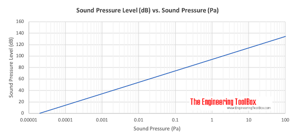

The chart below shows the sound pressure level decibel scale compared to the sound pressure Pascal scale.
Sound Pressure Level (dB) vs. Sound Pressure (Pa) Chart
Download and print Sound Pressure Level (dB) vs. Sound Pressure (Pa) Chart!
