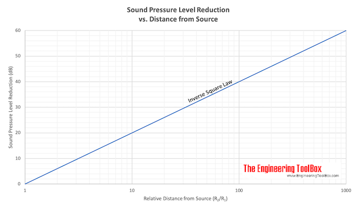

Doubling of the distance from a noise source reduces the sound pressure level with 6 decibel.
In a free field - a doubling of the distance from a noise source reduces the sound pressure level with 6 decibel.
This - the Inverse Square Law - can be expressed in a diagram like
sound pressure level vs. distance from source - inverse square law
Download and print the Inverse Square Law chart - Sound pressure level reduction vs. distance from source
dL = Lp2 - Lp1
     = 10 log (R2 / R1)2
     =  20 log (R2 / R1)                                        (1)
dL = difference in sound pressure level (dB)
Lp1 = sound pressure level at location 1 (dB)
Lp2 = sound pressure level at location 2 (dB)
R1 = distance from source to location 1 (ft, m)
R2 = distance from source to location 2 (ft, m)
