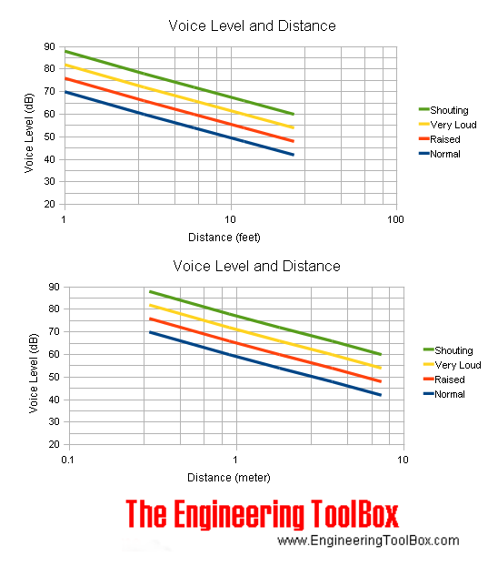

Required Voice Level at Distance
Distance and perception of voice.
Talking with
  • a normal voice approximates to a sound pressure level of 70 dB
  • a raised voice approximates to a sound pressure level of 76 dB
  • a very loud voice approximates to a sound pressure level of 82 dB
  • a shouting voice approximates to a sound pressure level of 88 dB
at a distance of 1 ft (0.3 m).
For every doubling of the distance from the noise source the sound pressure level decrease with 6 decibels:
DistanceVoice Level (dB PSIL)
(ft)(m)NormalRaisedVery LoudShouting
1 0.3 70 76 82 88
3 0.9 60 66 72 78
6 1.8 54 60 66 72
12 3.7 48 54 60 66
24 7.3 42 48 54 60
