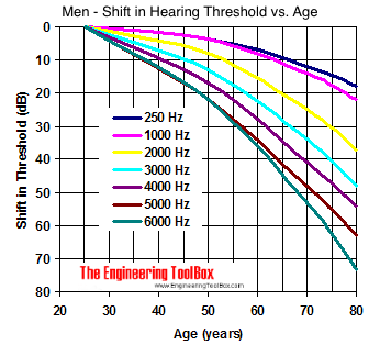

Men
Men - age and shift in hearing threshold

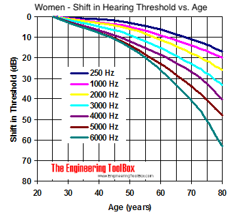

Women
Women - age and shift in hearing threshold
