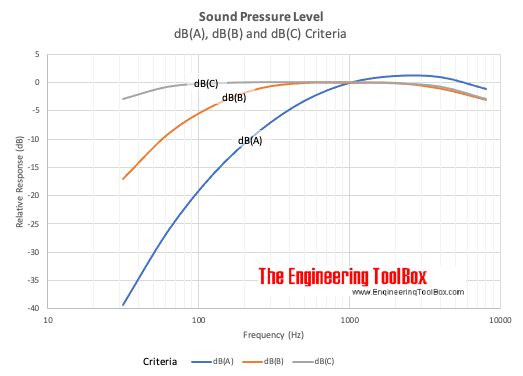

Sound - Decibel A, B and C Criteria
Download and print Sound Pressure Level - db(A), dB(B) and dB(C) criteria chart

dB(B) and dB(C)
The decibel C filter is practically linear over several octaves and is suitable for subjective measurements at very high sound pressure levels. The decibel B filter is between C and A. The B and C filters are seldom used.
Comparing dB(A), dB(B) and dB(C)
The A, B and C decibel filters compared:
Decibel A, B and C
Relative Response (dB)Frequency (Hz)
31.2562.51252505001000200040008000
dB(A) -39.4 -26.2 -16.1 -8.6 -3.2 0 1.2 1 -1.1
dB(B) -17 -9 -4 -1 0 0 0 -1 -3
dB(C) -3 -0.8 -0.2 0 0 0 -0.2 -0.8 -3

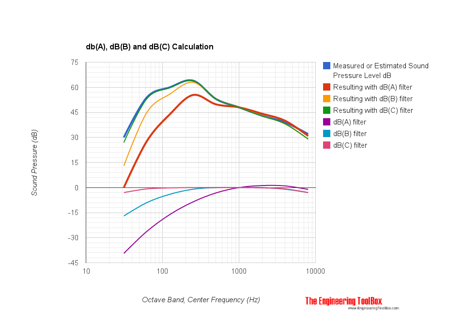

db(A), dB(B) and dB(C) Calculation Spreadsheet
Sign in to your Google Account to copy and modify an example spreadsheet with the dB(A), dB(B) and dB(C) calculation and the graph below.
dbA decibel calculation
