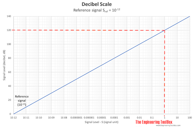

Decibel Scale

Example - Sound Power from a Fan
Decibel Scale - example fan 120 dB
A fan creates 1 W of sound power. The noise level from the fan in decibel can be calculated as
L = 10 log ((1 W) / (10 -12 W ))
    = 120 dB
