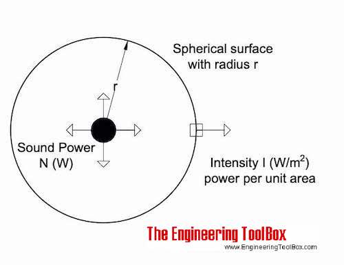

Sound Intensity
Acoustic power of sound per unit area.
Sound Intensity
The sound intensity is the sound power transmission through a surface (W/m2) - a vector quantity with direction through a surface.
I = N / A                                             (1)
I = sound intensity (W/m2)
N = sound power through surface area (W)
A = surface area (m2)

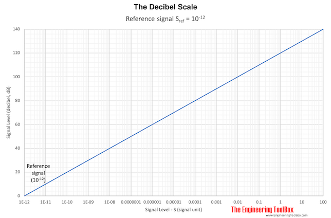

Sound Intensity Level
The dynamic range of human hearing and sound intensity spans from 10-12 W/m2 to 10 - 100 W/m2. The highest sound intensity possible to hear is 10,000,000,000,000 times as loud as the quietest!
This span makes absolute values for sound intensity impractical in normal use. A more convenient way to express sound intensity is the relative logarithmic decibel scale with reference to the lowest human hearable sound - 10-12 W/m2 (0 dB).
Note! In US the reference 10-13 watts/m2 is commonly used.
Sound Intensity Level can be expressed as:
LI = 10 log (I / Iref)
   = 10 log10(I) + 120                              (2)
LI = sound intensity level (dB)
Iref = 10-12 - reference sound intensity - the threshold of hearing (W/m2)
The logarithmic sound intensity level scale match the human sense of hearing. Doubling the intensity increases the sound level with 3 dB(10 log (2)).
Decibel Scale
The Decibel Scale
Example - Sound Intensity
The difference in dB for intensity 10-8 watts/m2 and 10-4 watts/m2 (10000 units) can be calculated  as
ΔLI = 10 log ((10-4 watts/m2) / (10-12 watts/m2)) - 10 log (( 10-8 watts/m2) / ( 10-12 watts/m2))
= 40 dB
Increasing the sound intensity by a factor of
  • 10 raises its level by 10 dB
  • 100 raises its level by 20 dB
  • 1000 raises its level by 30 dB
  • 10000 raises its level by 40 dB
  • and so on

Sound Power, Intensity and Distance to Source
Sound intensity
Sound intensity decreases with the distance to the source. Sound intensity vs. distance can be expressed:
I = N / 4 πr2                                   (3)
Nsound power (W)
π = 3.14
r = radius or distance from source (m)
