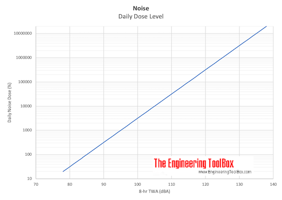

Daily noise dose as an 8-hr TWA for different daily noise doses:
Noise - Maximum Daily Dose Level
Daily Noise Dose
8-hr TWA
(dB(A))
20 78.0
30 79.8
40 81.0
50 82.0
60 82.8
70 83.5
80 84.0
90 84.5
100 85.0
200 88.0
400 91.0
600 92.8
800 94.0
1,000 95.0
1,500 96.8
2,000 98.0
4,000 101.0
6,000 102.8
8,000 104.0
10,000 105.0
20,000 108.0
40,000 111.0
60,000 112.8
80,000 114.0
100,000 115.0
150,000 116.8
200,000 118.0
400,000 121.0
600,000 122.8
800,000 124.0
1,000,000 125.0
2,000,000 128.0
4,000,000 131.0
6,000,000 132.8
8,000,000 134.0
10,000,000 135.0
