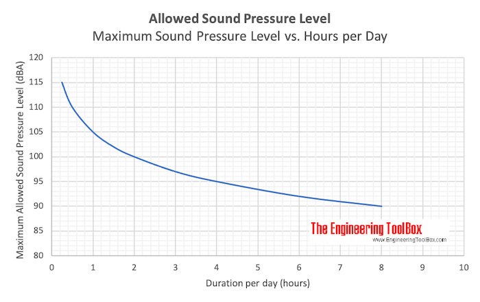

Maximum A-weighted sound pressure levels allowed by the U.S. Occupational Safety and Health Administration - OSHA -  for periods in a working day:
Sound Pressure Level - OSHA A-Weighted per Day
Duration per Day
(hr)
Maximum Allowed Sound Pressure Level
(dBA)
8 90
6 92
4 95
3 97
2 100
1.5 102
1 105
0.5 110
less than 0.25 115
Maximum allowable sound pressure level per day
Download and print Maximum Allowable Sound Pressure Level per Day chart
