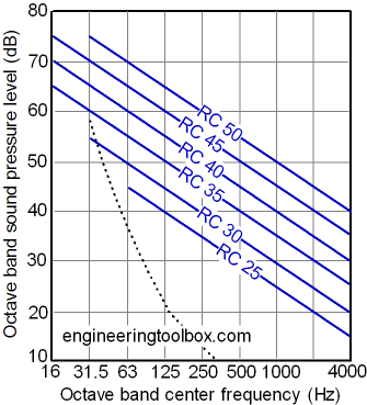

The Room Criteria (RC) is used to measure background noise in buildings for frequencies ranging 16 to 4000 Hz.
Room Criteria (RC) measures the background noise in buildings over frequencies ranging 16 Hz to 4000 Hz.
RC - room criteria curves
RC requires a determination of the mid-frequency average level and the perceived balance between high and low frequency sound.
