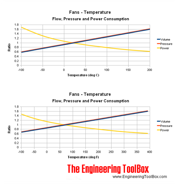

Volume, Pressure and Power Ratio Chart
The volume, pressure and power ratios are expressed in the chart below. The chart is based on a NTP reference with temperature of 20 oC .

Example - Fan with Hot Air
A fan delivers 10000 m3 /h of hot air at 60 oC . The total pressure loss in the system at this volume is estimated to 500 Pa .
Decide the correct air volume and pressure for choosing a fan from the manufacturers data. Decide the power consumption.
Since the air volume is estimated for the hot air, the correct volume for the fan is 10000 m3 /h .
The pressure coefficient is approximately 1.15 for air at 60 oC according the chart. The correct pressure in the manufacturing data sheet should be
500 x 1.15
= 575 Pa
The power consumption according the manufacturing data is 2.5 kW . The power coefficient is approximately 0.88 for air at 60 oC according the chart. The correct power consumption should be
2.5 kW x 0.88
= 2.2 kW

Example - Fan with Combustion Air
10000 m3 /h of normal standard air at 20 oC shall be transported at an operating combustion air temperature of 180 oC . The total pressure developed at 180 oC is estimated to 500 Pa .
Decide the correct air volume and pressure for choosing the fan from the manufacturers data and decide the total pressure for selecting the fan!
The volume coefficient in the chart above is 1.55 at 180 oC . The operating volume flow for selecting the fan would be
10000 x 1.55
= 15500 m3 /h
The pressure coefficient for air at 180 oC is approximately 1.55 according the chart. The correct pressure used in the manufacturing data sheet should be
500 x 1.55
= 775 Pa
The power consumption according the manufacturing data is 4 kW . According the chart the power coefficient is approximately 0.65 . The correct power consumption should be
4 kW x 0.65
= 2.6 kW
