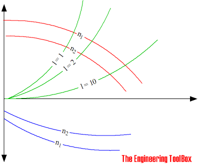

Pressure head as function of air flow volume may be expressed in a diagram like the one below:
fan capacity diagram
  • red lines are pressure heads as function of air volume flow and speed of the fan
  • green lines marked - l - are throttle lines
  • blue lines are power consumption
