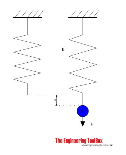

Hooke's law - force, elongation and spring constant.
Hooks law - force to extend or compress spring
The force required to extend or compress a spring can be expressed with Hooke's Law as
F = - k s                                    (1)
F = force (N)
k  = spring constant (N/m)
s = extension or compression distance (m)

Hook's Law of Elasticity
In the generalized variation of Hooke's law it states that the strain/deformation of an elastic object or material is proportional to the stress applied to it. It may be expressed mathematically as
σ = E ε                              (2)
σ = stress (Pa)
E = Young's Modulus of Elasticity (Pa)
ε = strain (m/m)
