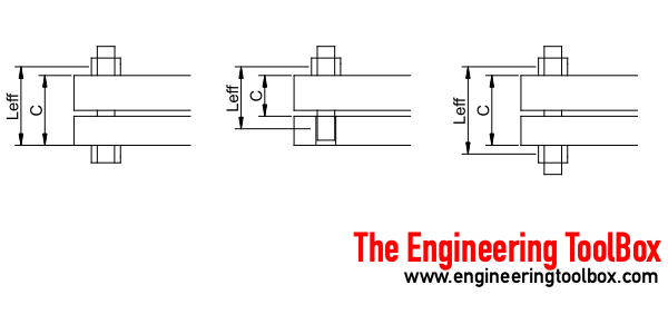

Bolt stretching according Hook's Law can be calculated as
dl = F L / E A                      (1)
dl = change in length of bolt (inches, m)
F = applied tensile load (lb, N)
L = effective length of bolt where tensile strength is applied (inches, m)
E = Young's Modulus of Elasticity (psi, N/m2)
A = tensile stress area of the bolt (square inches, m2)

Example - Bolt Stretching - Imperial Units
  • stud diameter : 7/8 inches
  • thread pitch : 9
  • Young's Modulus steel : 30 106 psi
  • designed bolt load : 10000 lb
  • effective length : 5 inches
The tensile stress area can be calculated as
A = 0.7854 ((7/8 in) - 0.9743 / 9)2
    = 0.46 (in2)
The elongation can be calculated as
dl = (10000 lb) (5 in) / ((30 106 psi) (0.46 in2))
    = 0.0036 (inches)
The tensile stress can be calculated as
σ = (10000 lb) / (0.46 in2)
   = 21740 psi
