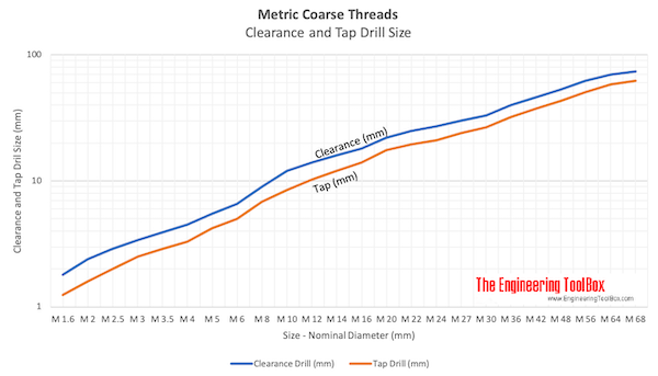

Metric Threads - Coarser Threads
The table below indicates some of the most used coarse threads up to size M 68. Note that the ISO 724 standard specifies threads up to M 300. The table below is not complete.
| Size - Nominal Diameter (mm) | Pitch1) (mm) | Clearance Drill (mm) | Tap Drill (mm) | Tensile Stress Area (mm2) |
| M 1.6 | 0.35 | 1.8 | 1.25 | |
| M 2 | 0.40 | 2.4 | 1.60 | |
| M 2.5 | 0.45 | 2.90 | 2.00 | |
| M 3 | 0.50 | 3.40 | 2.50 | |
| M 3.5 | 0.60 | 3.90 | 2.90 | |
| M 4 | 0.70 | 4.50 | 3.30 | 8.78 |
| M 5 | 0.80 | 5.50 | 4.20 | 14.2 |
| M 6 | 1.00 | 6.60 | 5.00 | 20.1 |
| M 8 | 1.25 | 9.00 | 6.80 | 36.6 |
| M 10 | 1.50 | 12.00 | 8.50 | 58.0 |
| M 12 | 1.75 | 14.00 | 10.20 | 84.3 |
| M 14 | 2.00 | 16.00 | 12.00 | |
| M 16 | 2.00 | 18.00 | 14.00 | 157 |
| M 20 | 2.50 | 22.00 | 17.50 | 245 |
| M 22 | 2.50 | 25.00 | 19.50 | |
| M 24 | 3.00 | 27.00 | 21.00 | 353 |
| M 27 | 3.00 | 30.00 | 24.00 | |
| M 30 | 3.50 | 33.00 | 26.50 | 561 |
| M 36 | 4.00 | 40.00 | 32.00 | 817 |
| M 42 | 4.50 | 46.00 | 37.50 | 1120 |
| M 48 | 5.00 | 53.00 | 43.00 | 1470 |
| M 56 | 5.50 | 62.00 | 50.50 | 2030 |
| M 64 | 6.00 | 70.00 | 58.00 | 2680 |
| M 68 | 6.00 | 74.00 | 62.00 |
1) For metric threads pitch is the distance between threads.
- 1 mm = 0.039 inches
Download and print metric coarce threads clearance and tap drill chart
