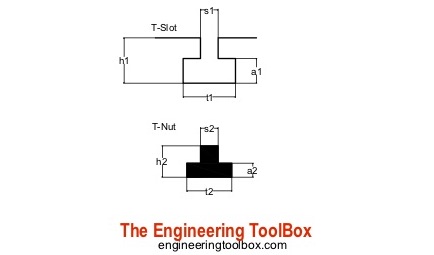

T-Slots and T-Nuts - Metric Sizes
Standard metric T-slots and T-nuts.
Standard metric T-Slots and T-nuts
Standard Metric T-Slots
T-Slots - Metric Sizes
Sizes1
(mm)
t1
(mm)
a1
(mm)
h1
(mm)
M4 5 10 - 11 3.5 - 4.5 8 - 10
M5 6 11 - 12.5 5 - 6 11 - 13
M6 8 14.5 - 16 7 - 8 15 - 18
M8 10 16 - 18 7 - 8 17 - 21
M10 12 19 - 21 8 -9 20 - 25
M12 14 23 - 25 9 - 11 23 - 28
M16 18 30 - 32 12 - 14 30 - 36
  • 1 inch = 25.4 mm
Standard Metric T-Nuts
Sizes2
(mm)
t2
(mm)
a2
(mm)
h2
(mm)
M4 5 9 2.5 6
M5 6 10 4 8
M6 8 13 6 10
M8 10 15 6 12
M10 12 18 7 16
M12 14 22 8 19
M16 18 28 10 25
