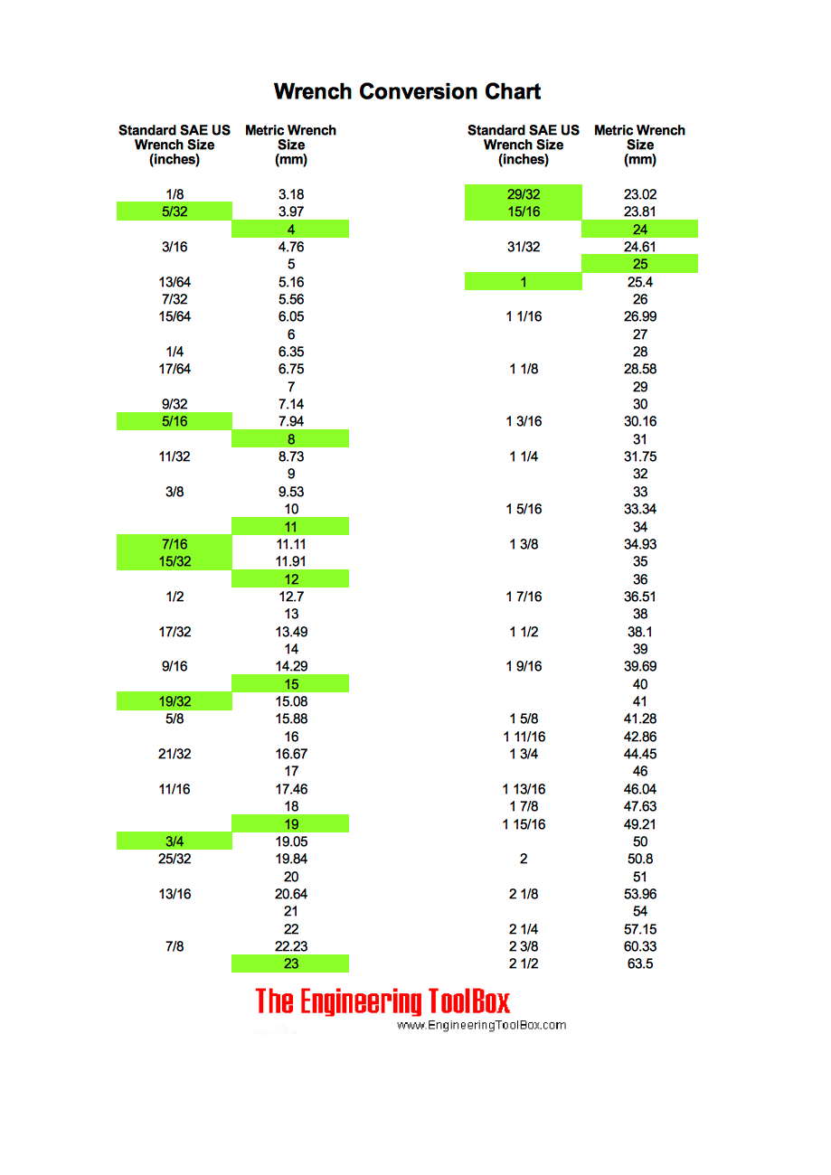

Wrench Size Conversion Chart – Metric (mm) to SAE (Inches)
Convert between metric and SAE (inch) wrench sizes with this comprehensive comparison chart. Find the closest equivalent sizes for your tools, whether working with US standard (SAE) or metric fasteners.
Wrench - inches vs mm
Wrench Spanners - Inches vs. mm
Standard SAE U.S. Wrench/Spanner Size
(inches)
Metric Wrench/Spanner Size
(mm)
1/8 3.18
5/32 3.97
4
3/16 4.76
5
13/64 5.16
7/32 5.56
15/64 6.05
6
1/4 6.35
17/64 6.75
7
9/32 7.14
5/16 7.94
8
11/32 8.73
9
3/8 9.53
10
11
7/16 11.11
15/32 11.91
12
1/2 12.7
13
17/32 13.49
14
9/16 14.29
15
19/32 15.08
5/8 15.88
16
21/32 16.67
17
11/16 17.46
18
19
3/4 19.05
25/32 19.84
20
13/16 20.64
21
22
7/8 22.23
23
29/32 23.02
15/16 23.81
24
31/32 24.61
25
1 25.40
26
1 1/16 26.99
27
28
1 1/8 28.58
29
30
1 3/16 30.16
31
1 1/4 31.75
32
33
1 5/16 33.34
34
1 3/8 34.93
35
36
1 7/16 36.51
38
1 1/2 38.10
39
1 9/16 39.69
40
41
1 5/8 41.28
1 11/16 42.86
1 3/4 44.45
46
1 13/16 46.04
1 7/8 47.63
1 15/16 49.21
50
2 50.80
51
2 1/8 53.96
54
2 1/4 57.15
2 3/8 60.33
2 1/2 63.5
