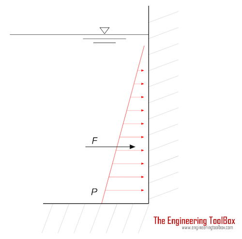

Thrust force acting on a submerged surface
The thrust force acting on a surface submerged in a liquid can be calculated as
F = p a A
= ρ g h a A                           (1)
F = thrust force (N)
p a = ρ g h a = average pressure on the surface (Pa)
A = area of submerged surface (m2)
h a = average depth (m)
ρ = density (kg/m3 )  (water 1000 kg/m3 )
Example - The thrust force acting on the side of a container
The trust force acting on the submerged vertical side of a container can be calculated as
F = p a A
= ( (p t + p b ) / 2) A
= ( ρ g (h t + h b ) / 2) A (2)
p t = pressure at the top of the submerged surface (Pa)
p b = pressure at the bottom of the submerged surface (Pa)
h t = depth at the top of the submerged surface (m)
h b = depth at the bottom of the submerged surface (m)
The thrust on a surface with width 1 m and height from 0 m to 2 m - in a water-filled container can be calculated as
F = ( ρ g (h t + h b ) / 2) A
= (1000 kg/m3 ) (9.81 m/s2) ((0 m) + (2 m)) / 2) ( (1 m) (2 m) )
= 19620 N
= 19.6 kN
