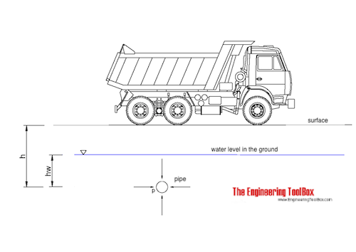

Pressure in ground due to soil, water and transport
The pressure acting on an object in the ground - typical on the outside of a pipe can be calculated as
p = psoil + pwater + ptransport               (1)
p = pressure acting on object in the ground (Pa)
psoil = pressure caused by the weight of the soil above the object (Pa)
pwater = hydrostatic pressure caused by the weight of the water above the object (Pa)
ptransport = pressure caused by the transport load on surface of the soil (Pa)

Pressure caused by soil
psoil = ρs g (h - hw) + ρsw g hw                 (2)
ρs = density of soil above the groundwater (typical 1800 - 1900 kg/m3)
h = depth from surface to object (m)
hw = depth from groundwater level to object (m)
ρswdensity of soil below groundwater level (reduced due to Buoyancy of soil - typical value 1100 kg/m3)
Pressure caused by groundwater
pwater = ρw g hw                 (3)
ρsw = density water  (1000 kg/m3)

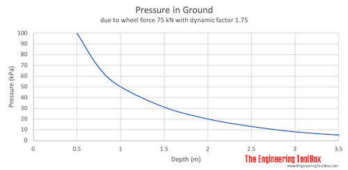

Pressure caused by transport
The pressure caused by transport depends on the force (weight) on each wheel. The figure below indicates the the pressure at different depths for wheel force 75 kN (7500 kg) with dynamic factor 1.75.
Pressure in ground due to transport load

ptransport = aprox. from the diagram  - 20 kPa

Pressure from transport is calculated for wheel force 75 kN (7500 kg) with dynamic factor 1.75.
