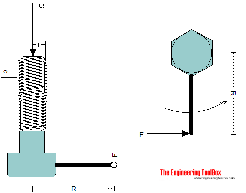

A screw jack is a mechanical device that can increase the magnitude of an effort force.
Screw jack - load and effort force
The effort force for a screw jack when neglecting friction can be expressed as
F = (Q p) / (2 π R)                                 (1)
F = effort force at the end of the arm or handle (lb, N)
Q = weight or load (lb, N)
p = pitch - distance or lead of thread in one turn  (in, m)
R = lever-arm radius (in, m)
The torque acting on the screw can be calculated as
T = F R                                 (2)
T = torque (lb in, Nm)
Example - Screw jack without friction
If the load on a screw jack is 50000 lb, the lever-arm is 20 inches and the pitch equals 1/8 inches - the effort force can be estimated to
F = ((50000 lb) (1/8 in)) / (2 π (20 in))
    = 49.8 lb
T = (49.8 lb) (20 in)
    = 995 lb in
    = 82.9 lb ft
Example - Metric Screw Lift
A M24 metric screw with pitch 3 mm is used in a mechanical screw lift with load 225 kN. The lever arm is 0.5 m. The effort force required can be calculated as
F = ((225000 N) (0.003 m)) / (2 π (0.5 m))
    = 215 N
T = (215 N) (0.5 m)
    = 107 Nm

Screw Jack with Friction
For motion in the same direction as the load (load assist the screw jack), the effort force can expressed as
F = Q ( (2 π μ r - p) / (2 π r + μ p) ) (r / R)                                   (2)
r = pitch radius of screw (in)
μ = friction coefficient
For motion in the opposite direction as the load (load resists the screw jack), the effort force can expressed as
F = Q ( (2 π μ r + p) / (2 π r - μ p) ) (r / R)                                 (3)
