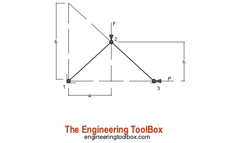

The toggle mechanism is made of two arms linked together. Point 1 is fixed, point 3 can move horizontally (as indicated in this principal drawing). The effort force acts vertically in point 2.
The horizontal force acting in point 3 can be calculated for arms with equal or unequal lengths.
Arms with equal lengths
P = F a / 2 h                            (1)
P = horizontal force in point 3 (N, lb)
F = effort force (N, lb)
a = length (m, ft)
h = height (m, ft)
Arms with unequal lengths
P = F a / b                             (2)
b = length (m, ft)

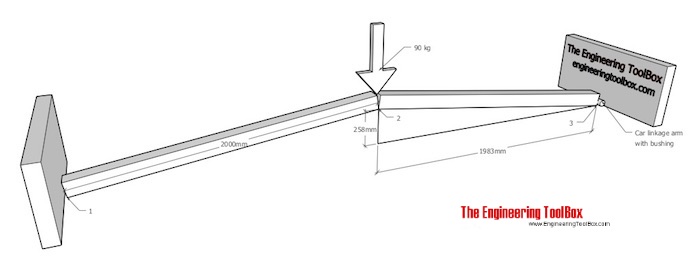

Example - An Improvised Press for Replacing Car Bushings
A press to remove/refit bushings in car linkage arms can be improvised with two pieces of lumber:
toggle joint - improvised bush press
The effort force acting on the toggle joint (in point 2) with a person with weight 90 kg can be calculated as
F = (90 kg) (9.81 m/s2)
  = 883 N
The force acting on the bush (in point 3) can be calculated as
P = F a / 2 h
   = (883 N) (1983 mm) / (2 (258 mm))
   = 3393
The force ratio is
 Fr = (3393 N) / (883 N)
    = 3.8
- the initial effort force is amplified near four times
