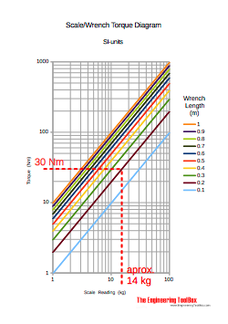

Scale Wrench Torque Diagram - SI units
Scale torque wrench diagram - SI units
Download and print Scale Wrench Torque Diagram
Example - Torque Settings for a Cylinder Head
The torque settings for a cylinder head in a car engine are specified to 30 Nm.
According to the diagram above with a wrench with length 0.2 m - the scale readings should be approximately
14 kg
Scale torque wrench - example diagram
