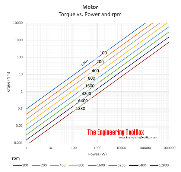

Motor - Torque vs. Power and rpm
Download and print Motor - Torque vs. Power and rpm chart
