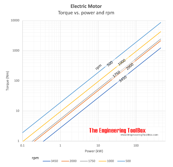

Note that the driving force of an electric motor is torque - not horsepower. The torque is the twisting force that makes the motor running and the torque is active from 0% to 100% operating speed.
The power produced by the motor depends on the speed of the motor and is
  • zero at 0% speed,  and
  • normally at it's top at operating speed
electric motor speed vs. torque power
Note ! - the full torque from zero speed is a major advantage for electric vehicles.

Electrical Motor Power, Velocity and Torque Equations
Torque in Imperial units can be calculated as
T inlb = P hp 63025 / n                          (1)
T inlb = torque (in lbf )
P hp =  horsepower delivered by the electric motor (hp)
n = revolution per minute (rpm)
Alternatively
T ftlb = P hp 5252 / n                         (1b)
T ftlb = torque (lbf ft)
  • 1 ft lbf = 1.356 Nm
Torque in SI units can be calculated as
T Nm = P W 9.549 / n                        (2)
T Nm = torque (Nm)
P W =  power (watts)
Electric Motor - Torque vs. Power and Speed
Electric Motor - Power vs. Torque and Speed
Electric Motor - Speed vs. Power and Torque
electric motor - change in speed and change in torque and power
Example - Torque from an Electrical Motor
The torque delivered from an electrical motor producing 0.75 kW (750 W) at speed 2000 rpm can be calculated as
T = ( 750 W ) 9.549 / (2000 rpm)
= 3.6 (Nm)
The torque delivered from an electrical motor producing 100 hp at speed 1000 rpm can be calculated as
T = (100 hp) 63025 / (1000 rpm)
= 6303 < (lbf in)
To convert to pound-force foot - divide the torque by 12 .
