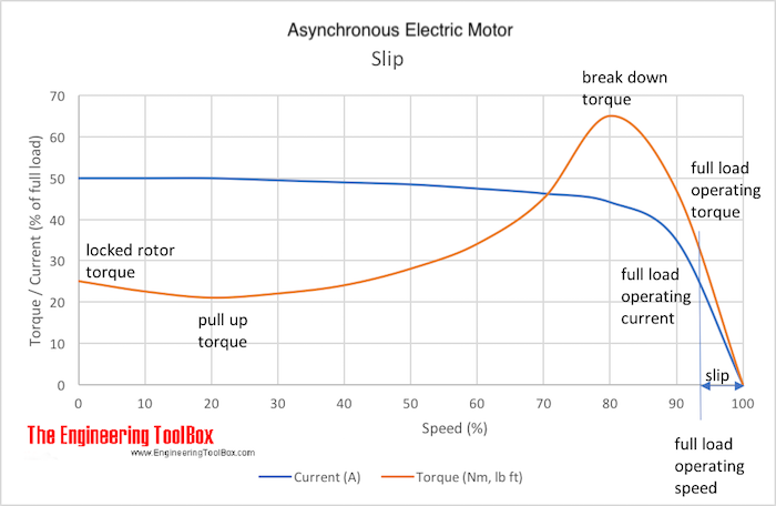

The torque developed by an asynchronous induction motor varies when the motor accelerates from zero to maximum operating speed.
electric motor current torque curves slip
Locked Rotor or Starting Torque
The Locked Rotor Torque or Starting Torque is the torque an electrical motor develops when starting at zero speed.
A high Starting Torque is more important for application or machines hard to start - like positive displacement pumps, cranes etc. A lower Starting Torque can be accepted for centrifugal fans or pumps where the start load is low or close to zero.
Pull-up Torque
The Pull-up Torque is the minimum torque developed by an electrical motor when it runs from zero to full-load speed (before it reaches the break-down torque point).
When a motor starts and begins to accelerate the torque in general will decrease until it reach a low point at a certain speed - the pull-up torque - before the torque increases until it reach the highest torque at a higher speed - the break-down torque - point.
The pull-up torque may be critical for applications that needs power to go through some temporary barriers achieving working conditions.
Break-down Torque
The Break-down Torque is the highest torque available before the torque decreases when the machine continues to accelerate to working conditions.
Full-load (Rated) Torque or Braking Torque
The Full-load Torque is the torque required to produce the rated power of an electrical motor at full-load speed.

NEMA Design
NEMA (National Electrical Manufacturers Association) have classified electrical motors in four different designs where torques and starting-load inertia are important criteria.
Accelerating Torque
Accelerating Torque = Available Motor Torque - Load Torque
