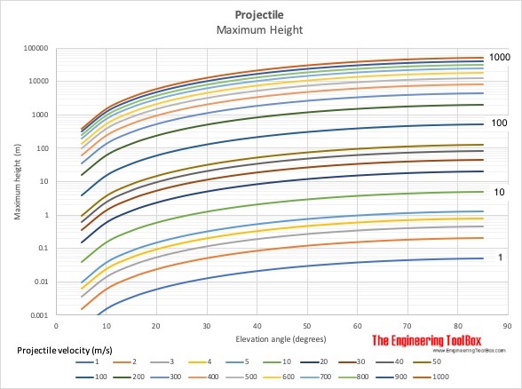

Projectile - velocity, elevation and maximum height
Note that friction force due to air resistance is neglected in the charts above. For higher velocities range and maximum height will be dramatically reduced.
