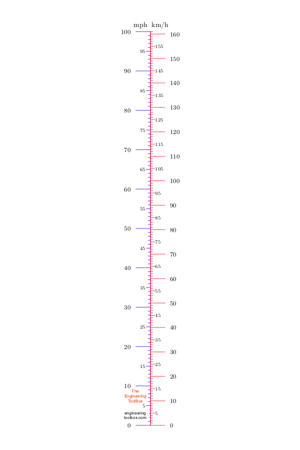

mph to km/h Converter
mph to km/h converter
Download and print mph to km/h Converter!

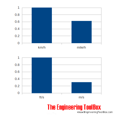

Velocity converter - km/h, mile/h, ft/s and m/s
