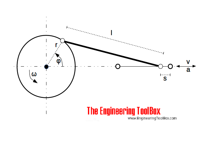

A connecting rod - conn-rod - mechanism converts rotating motion to reciprocating motion - or vice versa.
The position of the rod can be expressed as
s = r (1 - cos φ) + (λ / 2) r sin2φ                                (1)
s = position of the rod (m)
r = radius of crank (m)
φ = ω t
   = 2 π ns t
   = angular position of crank (rad)
ω = crank angular velocity (rad/s)
t = time (s)
ns = revolution per second (1/s)
λ = r / l
   = crank ratio
l = length of rod (m)
The velocity of the rod can be expressed as
v = ω r sin φ (1 + λ cos φ)                               (2)
v = velocity of rod (m/s)
The acceleration of the rod can be expressed as
a = ω2 r (cos φ + λ cos 2φ)                                (3)
a = acceleration of rod (m/s2)
