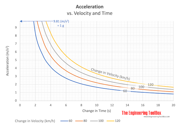

Acceleration Calculator
The calculator below can be used to calculate acceleration:
Acceleration vs. change in time and velocity
Download and print Acceleration vs. Change in Velocity and Time chart
