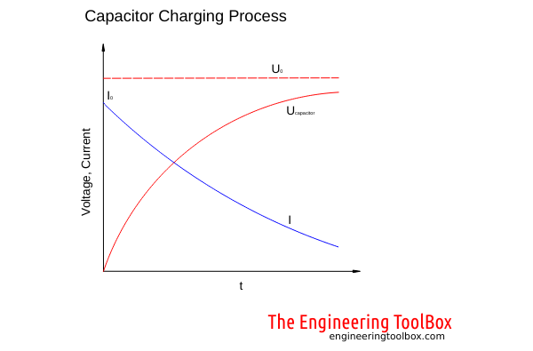

Charge and Applied Voltage
Charge in a capacitor is proportional to the applied voltage and can be expressed as
Q = C U                        (4)
C = constant of proportionality or capacitance (farad, F, µF )
A farad is an enormous capacitance so it is common to deal with microfarads (μF), nanofarads (nF) or picofarads (pF).
Capacitance
From (4) the capacitance can be expressed as
C = Q / U                         (5)
One farad is defined as the capacitance of a capacitor when there is a potential difference across the plates of one volt when holding a charge of one coulomb.
It is common to use µF (10-6 F) .
Example - Voltage over a Capacitor
A 5 µF capacitor is charged with 10 mC . The voltage across the capacitor can be calculated by modifying (4) to
U = Q / C
= (10 mC) (10-3 C/mC) / ((5 µF) (10-6 F/µF)
= 2000 V
= 2 kV

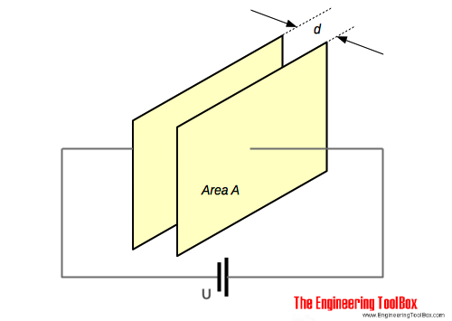

Parallel Plate Capacitor
The capacitance of a plate capacitor - as shown in the figure above - is proportional with the area A of the plate. The capacitance can be expressed as
C = ε r ε0 A / d                   (8)
A = area of plate (m2)
d = thickness of dielectric, distance between plates (m)
For a plate capacitor with multiple plates the capacitance can be expressed as
C = ε r ε0 A (n - 1) / d                      (8b)
n = number of plates
Example - Capacitance of a Plate Capacitor
The capacitance of a plate capacitor with area 5 cm2, 10 plates and distance 0.1 mm between the plates - with ceramic dielectric with relative permittivity 30 between the plates - can be calculated as
C = ( 8.85 10-12F/m ) (30) (5 cm2) (10-4 m2/cm2) (10 - 1) / ((0.1 mm) (10-3 m/mm))
= 11 10-9F
= 11 pF
