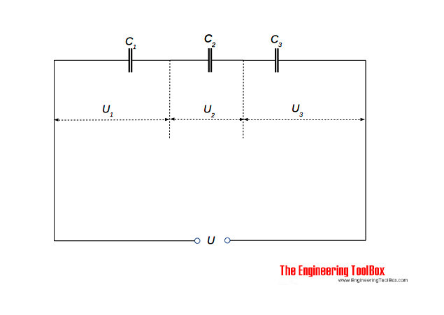

Capacitors in Series
Three capacitors C1 = 3 μF, C2= 6 μF and C3 = 12 μF are connected in series as indicated in the figure above. The voltage supply to the circuit is 230 V.
The equivalent circuit capacitance can be calculated with (2)
1 / C = 1 / ( 3 μF ) + 1 / (6 μF ) + 1 / ( 12 μF )
= (4 + 2 + 1) / 12
= 0.58 1/μF
- or transformed
C = 12 / (4 + 2 + 1)
= 1.7 μF
The total charge in the circuit can be calculated with
Q = U C
Q = charge (coulomb, C)
U = electric potential (V)
- or with values
Q = (230 V) (1.7 10-6 F)
= 3.91 10-4 C
= 391 μC
Since the capacitors are connected in series - the charge is 391 μC on each of them.
The voltage across capacitor 1 can be calculated
U1 = Q / C1
= (391 μC) / (3 μF)
= 130 V
The voltage across capacitor 2 can be calculated
U2= Q / C2
= (391 μC) / (6 μF)
= 65 V
The voltage across capacitor 3 can be calculated
U3 = Q / C3
= (391 μC) / (12 μF)
= 33 V

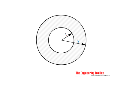

Capacitance of Two Coaxial Cylinders
capacitance coaxial cylinders
The capacitance of two coaxial cylinders as indicated in the figure can be calculated as
C = 2 π ε o ε r l / ln(r2/ r1 )                  (3)
ε o = absolute permittivity, vacuum permittivity (8.85 10-12 F/m, farad/m)
ε r = relative permittivity
l = length of cylinders
r2= radius of inner cylinder
r1 = radius of outer cylinder
