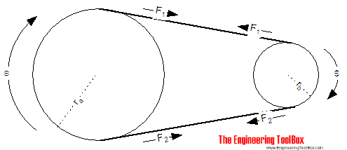

The torque available at the driven wheel or pulley (a) can be expressed as
T = (F2 - F1) ra                        (1)
T = torque (Nm)
F = force (N)
r = radius of wheel or pulley
The available power can be expressed as
P = T ωa = (F2 - F1) ra ωa                          (2)
P = power transmitted (watts)
ωa = angular velocity (rad/s)
