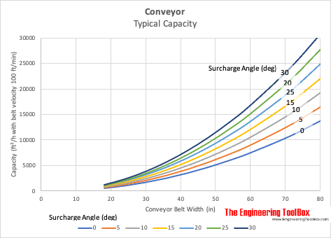

Typical Conveyor Capacity
Conveyor capacity

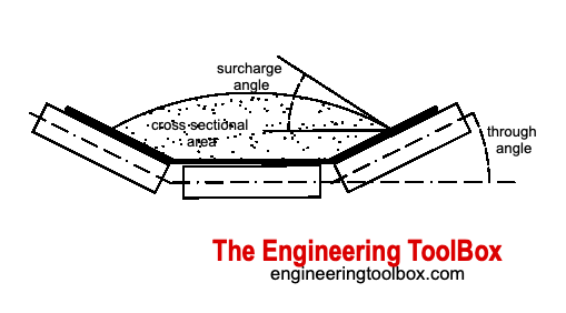

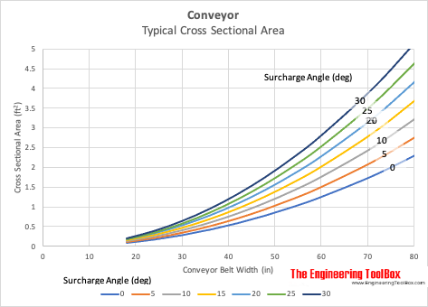

The product cross sectional area is defined by the idler trough shape and the product pile on top of the idler trough the trapezoid shape. This section on top of the trapezoid can be described with a circle and the angle this circle makes with the belt is the surcharge angle.
Typical Conveyor Cross Sectional Area
Conveyor capacity - cross sectional area

Typical Surcharge Angles
Conveyor belt
Conveyors - Surcharge Angles

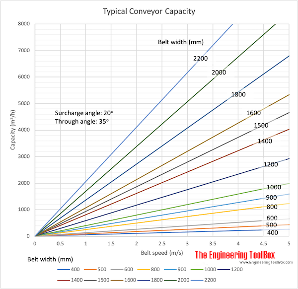

The chart below indicates typical conveyor capacity vs. belt speed and belt width.
Typical conveyor capacity chart vs. belt speed and belt width
Multiply the volume capacity (m3/h) from the chart with the bulk density (kg/m3) of the product to estimate the weight capacity.
