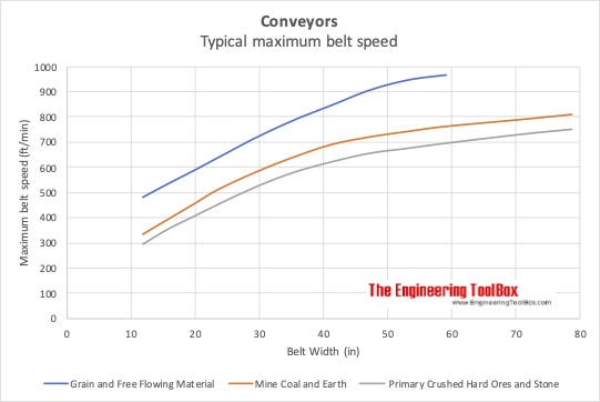

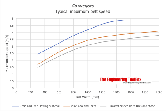

Maximum conveyor belt speed.
Typical maximum conveyor belt speeds for products like
  • Grain and Free Flowing Material
  • Mine Coal and Earth
  • Primary Crushed Hard Ores and Stone
are indicated in the charts below:
Conveyor maximum belt speed - grain, coal, earth, ore and stone
Conveyor maximum belt speed - grain, coal, earth, ore and stone - imperial units
