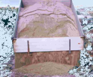

Stockpile - tipping or dumping angle
The angle of repose, or critical angle of repose, of a granular material is the steepest angle of descent or dip relative to the horizontal plane to which a material can be piled without slumping. At this angle, the material on the slope face is on the verge of sliding. Angle of repose - angle where materials will slide out of the tipped body - for some typical products:

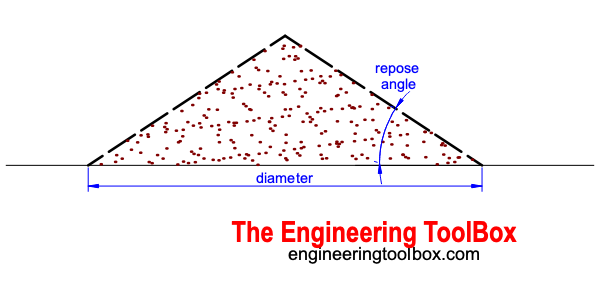

  • repose angle - the angle between the horizontal plane and the side of the pile
repose angle

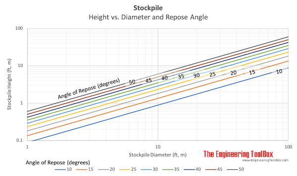

Stockpile height vs. diameter and repose angle
Download and print Stockpile Height vs. Diameter and Angle of Repose Chart
