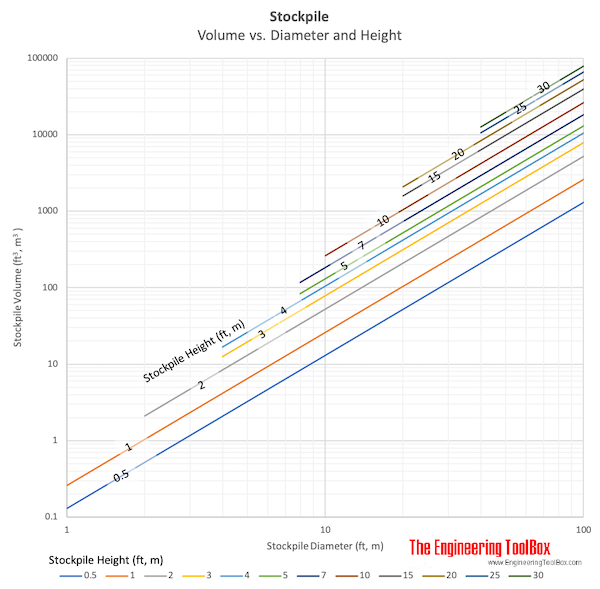

Stockpile - volume vs diameter and height
Download Stockpile Volume vs. Diameter and Height Chart

Example - Stockpiled Anthracite Coal
Anthracite coal with density 65 lb/ft 3 is stockpiled in a conical pile with diameter 30 ft and height 8 ft .
According the diagram above the volume of the pile is approximately 2000 ft3 .
The total mass of the pile can be calculated as
w = (65 lb/ft3 ) (2000 ft3 )
= 130000 lb
