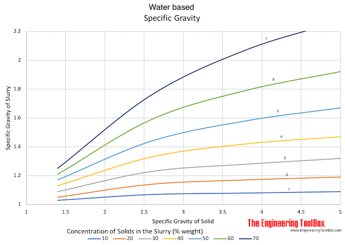

Specific Gravity of Water based Slurries
Specific gravity of water based slurries vs. specific gravity of the solid and consentration of the solid in the slurry:
